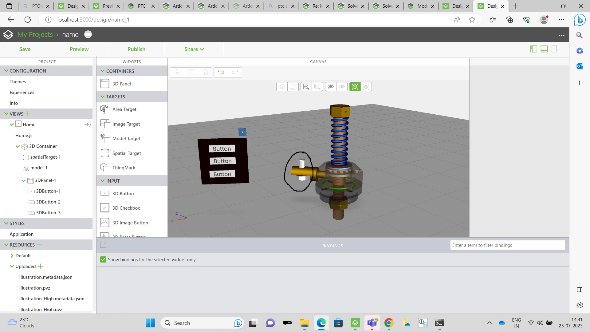

In 3D eyewear, If I touch the particular part of the model it should be highlighted or it should blink. Can we do that? Any reference model you have, please attach here, it will helps me.

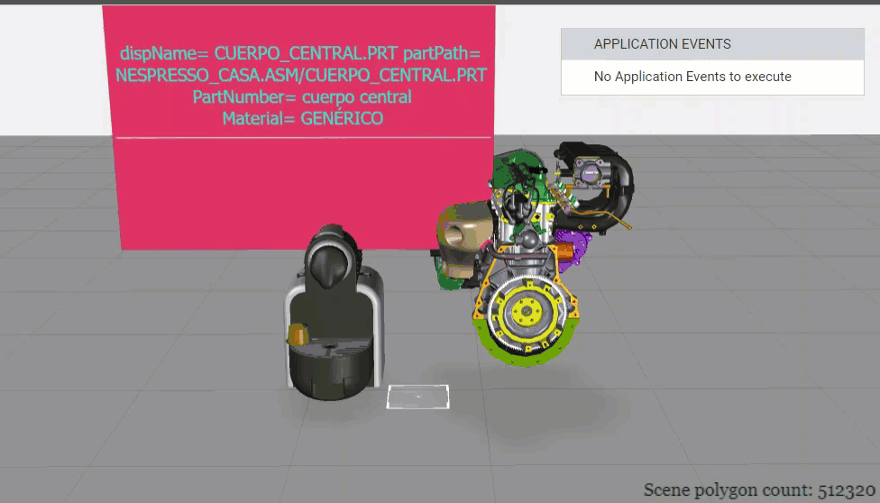

The default behavior will not blink when you click on model. For that you need first to identify the component in the userpick event and then with the selection (slection string like "<modelWidgetName>-<PathString>" e.g. "model-1/0/1/2 you can try to do some blink actions:

I was created one Model. In that model I have one component (Bolt), If I am touching the bold directly it should respond or it should highlight, can we do that in 3D eyewear.

YES, works no problem , but requires preparation. unfortunately I do not have a simple project. I posted in the past the following project but could not find the link directly to the  post - therefore here the project: 2023-07-25_14-14-32.gif
In the moment I do not have access to HL device. I remember that tested on HL in the past some months ago and it was working, I hope you can extract the functionality in your case is need.
Please test the project
1.) in preview
2.) on HoloLens - please , let me know if there is an issue (project not modified!)
3.) try to understand the code especially the usage of the  userpick event
4.) extract the code and  incorporate it into your project
