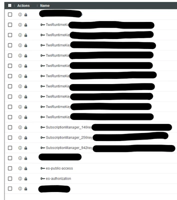

Is there any explanation how to configure a user group to be able to read live data from Thingworx? I maybe need to check if someone edited the rights of the developer group. It seems like that in View and Studio Preview the experience requests a "temporary" SubscriptionManager application key which quickly disappears again. Also I noticed that there are a bunch of old "temporary" SubscriptionManager and TwxRuntimeKey application keys which are not deleted:
Best
Sebastian
