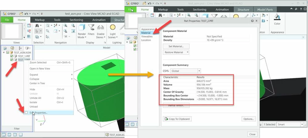

.... But the data is there -> here for example when we open a PVZ file in Creo View (MCAD license) and check the component properties:
So, we can find for each component the center of gravity and the bounding box information.
Possibly we can have soon this information also in the meta file when we load a file in Studio with the option to create a json meta file. I will check with dev team if such configuration could be setup in the current release / R&D reference VTS-719/ .
