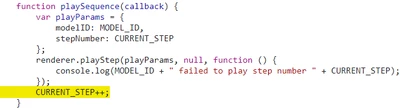

I had now time to work on that project again and i still have no good solution for my Problem.
I have a forward, arewind, and a play button.
Aslong i press forward or rewind everything is fine. The play button is the big issue. As you told, i can make my own play button. i made it yeah, but it's still bugged. And i found why it's behavior is not changeable.
This is a part of vuforia-angular.js
I dont know who had the great idea to make current_step++ at the end of the sequence but in my eyes this shouldnt be the case.
for this it would be enough to have a normal play (without increment) followed by a forward call.
