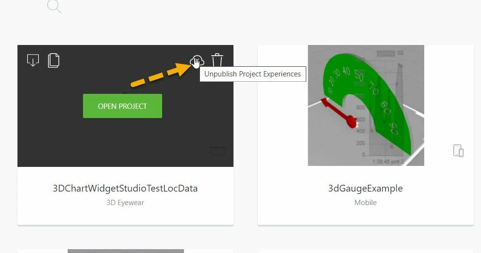

Hello Guys..
My PC had an OS problem and we need to format to fix it.
I saved majority of my project in my external disk but there were few projects that were not.
I can still see the published experience in my library but I cannot access the project now in vuforia to edit and since I dont have the folders already, i cant import them back as well.
Is there a way I can recover my files so that I can still modify it whenever I want to change something?
Another question, if I want to remove them in my library, how can I unpublish them without the project?
Best answer by RolandRaytchev
Hi @Adrian_G.
to backup the project there is no direct functionality in Studio out of the box.
What I do is to use one of the following options:
a.) perform regular update of my <USERNAME>/Documents/VuforiaStudio/Projects   folder on may machine -use e.g. Beyond Compare to synchronize the folder to backup folder
b.) otherwise all completed project / or history version are exported to a specific folders via the project export functionality
Regarding to the question when you lost data. If you can access directly the folders on your experience server then you can try to recover a project  - here please see the post  https://community.ptc.com/t5/Vuforia-Studio/Copy-project-from-ES-Server-back-to-Author-s-client-PC/m-p/784591#M10702
To delete a project form the server : when the project is in your Studio environment -you can :
simple click the unpublish symbol for the project.
When the project is not in your system but you know the URL of Experience Service and the name of the project and also you have a login with admin /or developer permissions - you can use the curl->Delete an existing project (replace "myproject" with the name of the project to be deleted):
curl -u user:password -H "Content-Type: Application/JSON" -H "X-Requested-With: XMLHttpRequest" -X "DELETE" https://localhost:2019/ExperienceService/content/projects/myproject/
