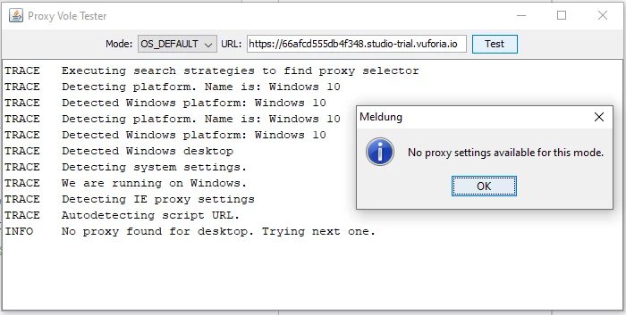

I can not publish my Project on Vuforia Studio and I'm having this Error "Internal Server Error"! Can you please help me!? Thank you
I  attached the log file for more informations
PS:
I already checked node.exe through the resmon.exe and it is set on "allowed, no restrictions"
I also tried publishing after disabling all Firewalls and I still get the same problem.

I'm seeing this in the log file:
[2020-03-17T07:34:23.744Z] error: [twx-studio:auth:oauthHandler] Error making request for oauth configClient network socket disconnected before secure TLS connection was established Error: Client network socket disconnected before secure TLS connection was established
 at connResetException (internal/errors.js:604:14)
 at TLSSocket.onConnectEnd (_tls_wrap.js:1513:19)
 at Object.onceWrapper (events.js:417:28)
 at TLSSocket.emit (events.js:323:22)
 at TLSSocket.EventEmitter.emit (domain.js:482:12)
 at endReadableNT (_stream_readable.js:1204:12)
 at processTicksAndRejections (internal/process/task_queues.js:84:21) {
 code: 'ECONNRESET',
 path: null,
 host: '66afcd555db4f348.studio-trial.vuforia.io',
 port: 443,
 localAddress: undefined
Looks like this may be a proxy issue on your network. Are you trying to publish on your corporate network? If there is a proxy on your network, you'll need to configure Studio to use the proxy as it does not inherit the browser proxy settings. See this Tech Tip for configuring the proxy: https://community.ptc.com/t5/Vuforia-Studio-and-Chalk-Tech/How-to-solve-Proxy-Script-based-configuration-issues-for/ta-p/595792
Another thing you can try is accessing your assigned Experience Service directly in your browser. Based on your log files that would be this: https://66afcd555db4f348.studio-trial.vuforia.io/ExperienceService/ui. You should be prompted for your credentials. If this works, but you can't validate/publish within Studio, then there is most likely a proxy causing issues.

I'm trying to publish from my corporate network. As I tried to publish from a private network it worked.
I've tried to configure the proxy of my corporate network following the steps in the Tech Tip and the test shows "No proxy sttings for this mode" (You can check the Screenshot below).
I asked my supervisor and he told me there is no proxy used in our department.
