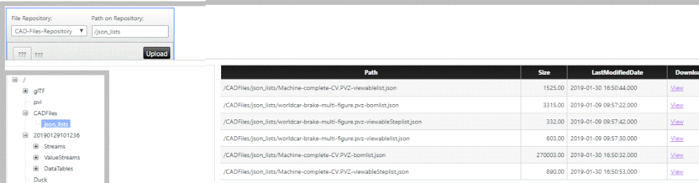

In this example the json files are saved in a thingworx repository (means a thing form template FileRepostiroy) e.g.  "CAD-Files-Repository" :

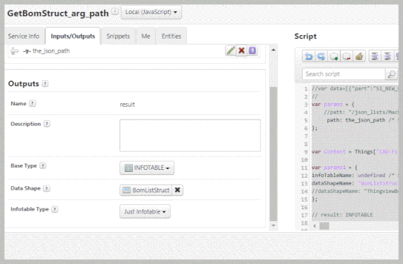

  • edit the CAD-Files-Repository thing and create a new service named  "GetBomStruct_arg_path"

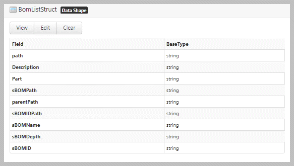

  • set  the BaseType : INFOTABLE . Set the DataShape property of the service - > here to BomListStuct -> this datashape need to be created  first . It should have the following Fields / property (all String type)
  • Create a service input parameter "the_json_path". Using this parameter we can past the repository path to the service
  • Edit the java script . We can past the following script (see the comments in the script area)

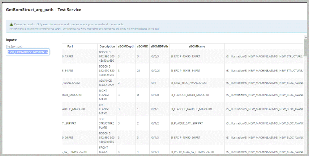

  • Test the  service:2019-02-04_19-09-10.gif

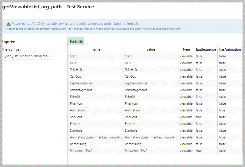

2.)Create a service for the BOM List /InfoTable (steps are similar to 1.)
  • edit the CAD-Files-Repository thing and create a new service named  "getViewableList_arg_path"

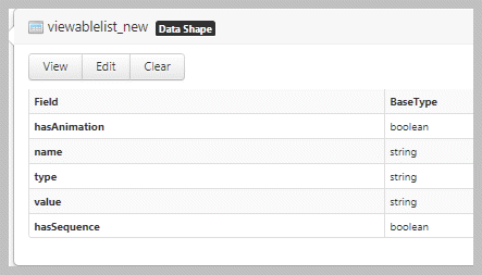

  • set  the BaseType : INFOTABLE . Set the DataShape property of the service - > here to viewablelist_new -> this datashape need to be created  first . It should have the following Fields / property (all String type)
  • Edit the java script . We can past the following script (see the comments in the script area):
var params = {
	//path: "/json_lists/Machine-complete-CV.PVZ-viewablelist.json" /* STRING */
 path: the_json_path /* STRING */
var Content = Things["CAD-Files-Repository"].LoadJSON(params);
var params1 = {
infoTableName: undefined /* STRING */,
dataShapeName: "viewablelist_new" /* DATASHAPENAME */
// result: INFOTABLE
var jsonTable = Resources["InfoTableFunctions"].CreateInfoTableFromDataShape(params1);
var result = DataShapes.ThingviewBomData.CreateValues();
for(i in Content.array){
 jsonTable.AddRow({name:Content.array[i].name,
 //type:Content.array[i].description,
 type:"viewable",
 value:Content.array[i].value,
 hasAnimation:Content.array[i].hasAnimation,
 hasSequence:Content.array[i].hasSequence
result = jsonTable;
  • Test the  service:
