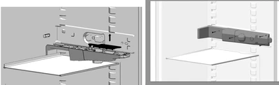

E.g. even that the left figure is not identical - the grey colored fridge frame is white, but appear due to light sceene grey. The right figure showing the expected result we want to achieve.

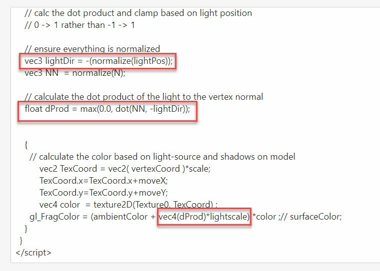

further I tested with  an old test project  with shader and see that we can handle the light  - change the display behavior via custom shader. Therefore I believe that the standard render behavior allows only a ambient light and possibly has one direction ray.

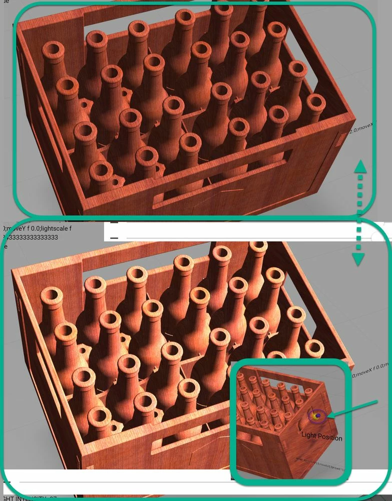

Here is  an example with customized  render - here the second tmlText-2 widget implements the shader :
additionally  to the ambient light we have here also a point light definition and also a light intensity. When we need more light sources we could  implement this to the shader. In the tmlText:
so we need to scale the code maked in red
I attached the demo project
