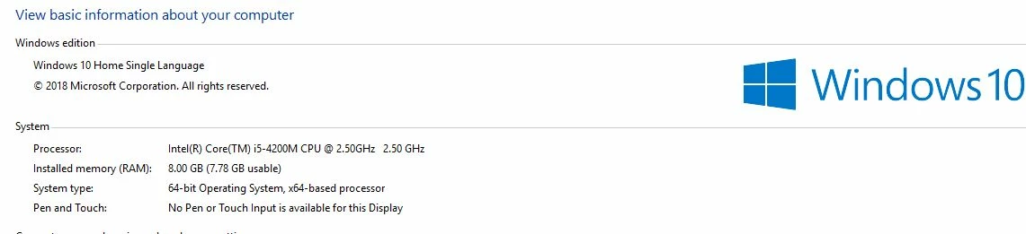

unble to install 30 day free trial version of Vuforia studio in my laptop with following error log
Please find the attached log file
kindly help

Please find the attachment of my system information.
This installer is getting installed in another laptop which has 4gb ram and win 7 pro OS
I need this to be installed in my present laptop for exploring
I even upgraded my java version to Java 8 upd 191 (64-bit)
What I understand from the log is that it seems to recognise my laptop as 3 bit NT??? what I know is that my laptop is 64 bit, is this because of the OS version being home edition??
Appreciate your help.

@spb There should not be an issue using Win 10 OS.
Delete the files under <Username>\AppData\Local\Apps\2.0\ and re-install the studio exe file. The AppData directory is an hidden directory, make sure to enable 'view hidden files' windows configuration .
Note: Right click the installer .exe and do Run as Administrator.
Also, review the existing post for suggestions which worked https://community.ptc.com/t5/Studio/Error-Installing-the-Thingworx-Studio/m-p/503579
