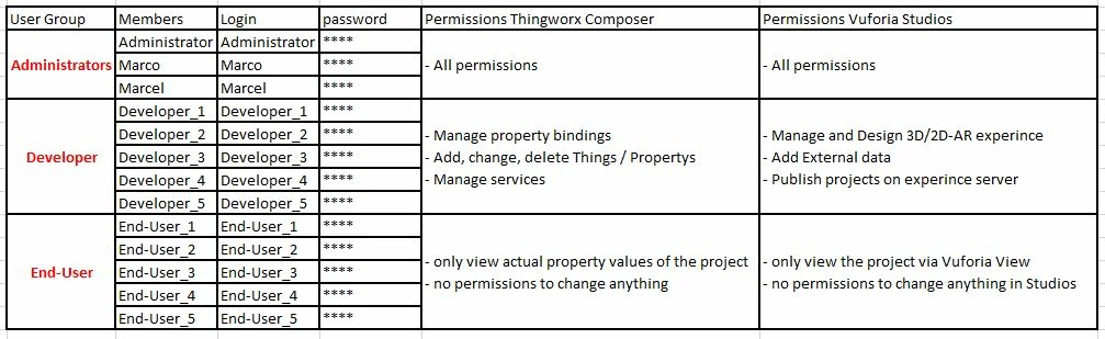

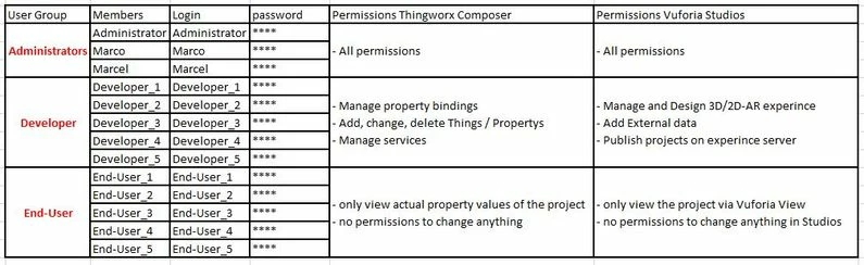

Maybe you can help me with my last problem to finish my project. I want to add different users and user groups wth own log ins which has different permissions. I tried to use the PTC help but i don't get it how user management works. I attached a screenshot of the different user groups and permissions. Maybe you can help me how to manage these.

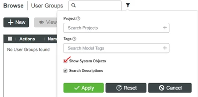

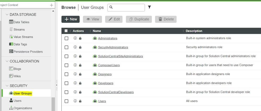

But there are also some pre-defined user groups that can be found in Security -> User Groups tab from Thingworx Composer. (If the groups are not visible after selecting the tab, check Show System Objects after pressing the Filter button as shown in the image below.)
You can create users and add them to the appropriate user group. By not adding them to any user group, the users will be part of the Users user group by default. You can keep your End Users here, so that they are not able to publish a Vuforia Studio Experience. You can also add your Developers to the Developers user group. This users will be able to publish experiences.thingworx.PNG

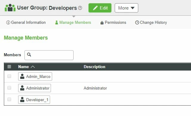

First of all I created an User named "Admin_Marco" and added this user to Administrators User Group.
Seems like this one worked fine. I have the same access to everything like the normal "Administrator" Login.

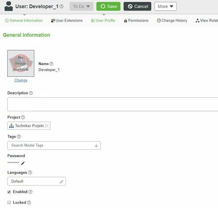

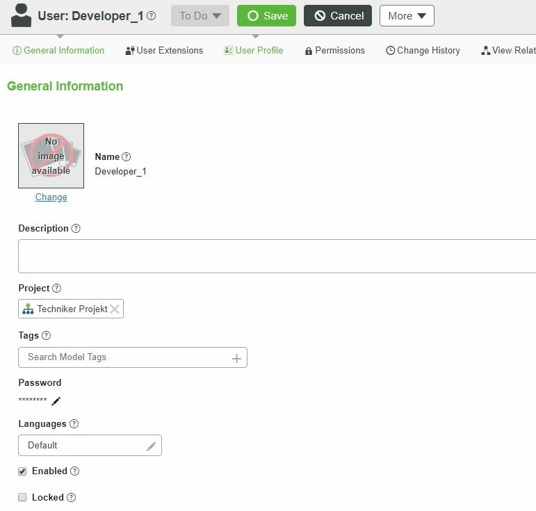

The next step was to create the User named "Developer_1" and added this user to Developers User Group.
Then i went to Permissions and the problems started:

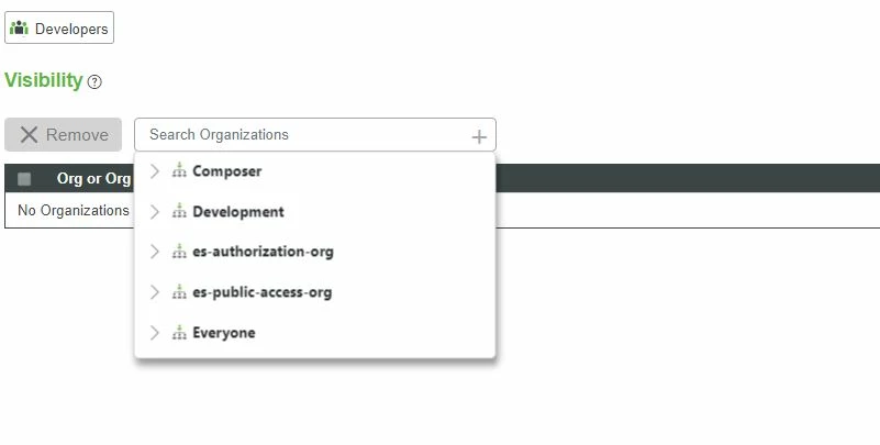

Permissions for Visibility:
Why i have to choose an Organization? What is an organization in Composer/Vuforia?
What i have to choose here for the permissions i described.

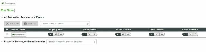

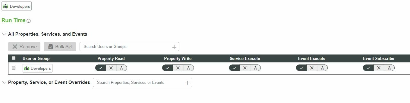

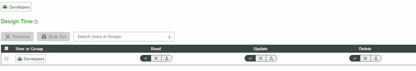

Permissions for Run Time:
I choosed the Developers User Group here and granted all permissions here

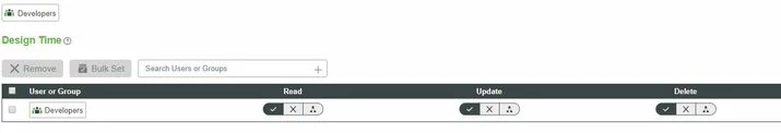

Permissions for Design Time:
I choosed the Developers User Group here and granted all permissions here.

Now i tried to Login with my Delevoper_1 User. But everything is empty. I can't even see the Project
i selected in the User-Profile of Developer_1.
Maybe you can tell me what i was doing wrong.
Feb 26, 2020 11:31 AM UTC
Hello MarcoNFT,
You can find more information about Thingworx' Security (including Organizations and how they can be used to manage permissions) on this page: http://support.ptc.com/help/thingworx_hc/thingworx_8_hc/en/#page/ThingWorx%2FHelp%2FComposer%2FSecurity%2FOrganizations%2FOrganizations.html%23
