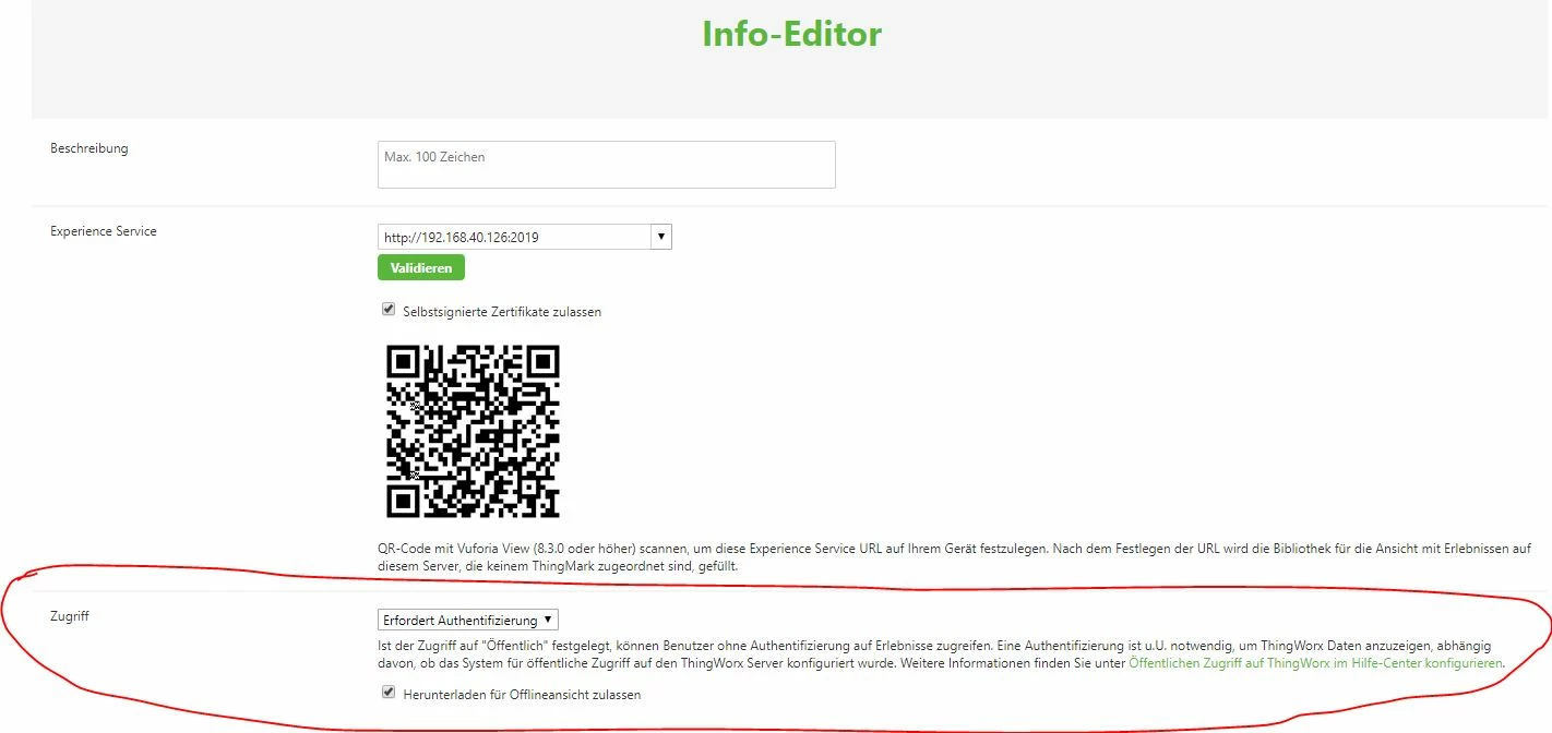

When i scan my Thingmark with Vuforia View or when I'm going to Preview in Vuforia Studios i have to Log in with username and password.
I have to this step only once. After i logged in Vuforia Studios and Vuforia View remembers the Log in credentials and i don't have to do this again.
Is it possible to manually Log In and Log Out with different User everytime?
Is it possible to log out automatically after a defined timeout? For example after 10 minutes?
