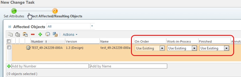

Has anyone had to add additional (new) disposition types (columns) to the AffectedActivityData link?
I have been requested to add two additional disposition columns to the affected items table.

Has anyone added new disposition selections (columns) to the Change Activity (AffectedActivityData link) beyond the standard OOTB three that exist today? If you have, I'd love to hear from you and get some advice on adding new disposition columns. The customizers guide is kind of sketchy on this subject.

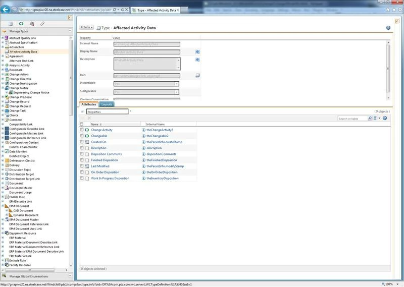

Ah yes, sorry. You're adding columns. Have you tried adding a global attribute and then created a new attribute on the Affected Activity Data type in the Type and Attribute Manager software?

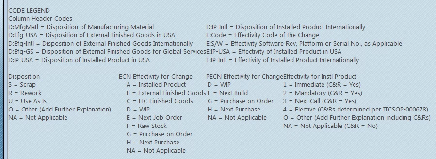

In parallel with getting the mechanics of Windchill to work for the Dispositions, it would be very interesting to see what dispositions people are using.
We currently have the following complex situation(we currently address these on the Change Request via a text field, then parse them out with a custom .jsp report):
[cid:image004.png@01CEA234.9FF86BA0]
I'd very much like to get us using a more "normal" approach to this, using Windchill Disposition tools.
