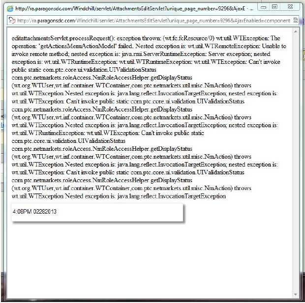

I get an occasional error that maybe someone in the group can shed some light on.
I have been loading up document (wtDocuments) and need to add a document as an attachment to the existing document. Sometimes, when activating the Attachments function, the applet will throw a Java error. Consequently, I get a null error across the current Product that only resolves by stopping and starting the services. I had a PTC ticket on this (C11260975). The PTC tech recommended several Java and browser settings; however I am still experiencing the issue.

Too good to be true. I got the same error even when using basic browser functionality to select and upload files.
editattachmentsServlet.processRequest(): exception thrown: (wt.fc.fcResource/0) wt.util.WTException: The operation: "getActionsMenuActionModel" failed. Nested exception is: wt.util.WTRemoteException: Unable to invoke remote method; nested exception is: java.rmi.ServerRuntimeException: Server exception; nested exception is: wt.util.WTRuntimeException: wt.util.WTRuntimeException: wt.util.WTException: Can't invoke public static com.ptc.core.ui.validation.UIValidationStatus com.ptc.netmarkets.roleAccess.NmRoleAccessHelper.getDisplayStatus(wt.org.WTUser,wt.inf.container.WTContainer,com.ptc.netmarkets.util.misc.NmAction) throws wt.util.WTException Nested exception is: java.lang.reflect.InvocationTargetException; nested exception is: wt.util.WTException: Can't invoke public static com.ptc.core.ui.validation.UIValidationStatus com.ptc.netmarkets.roleAccess.NmRoleAccessHelper.getDisplayStatus(wt.org.WTUser,wt.inf.container.WTContainer,com.ptc.netmarkets.util.misc.NmAction) throws wt.util.WTException Nested exception is: java.lang.reflect.InvocationTargetException; nested exception is: wt.util.WTRuntimeException: wt.util.WTException: Can't invoke public static com.ptc.core.ui.validation.UIValidationStatus com.ptc.netmarkets.roleAccess.NmRoleAccessHelper.getDisplayStatus(wt.org.WTUser,wt.inf.container.WTContainer,com.ptc.netmarkets.util.misc.NmAction) throws wt.util.WTException Nested exception is: java.lang.reflect.InvocationTargetException; nested exception is: wt.util.WTException: Can't invoke public static com.ptc.core.ui.validation.UIValidationStatus com.ptc.netmarkets.roleAccess.NmRoleAccessHelper.getDisplayStatus(wt.org.WTUser,wt.inf.container.WTContainer,com.ptc.netmarkets.util.misc.NmAction) throws wt.util.WTException Nested exception is: java.lang.reflect.InvocationTargetException
Can anyone make any sense of this? Many thanks! Kathy
