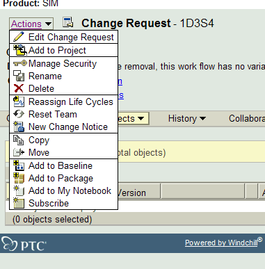

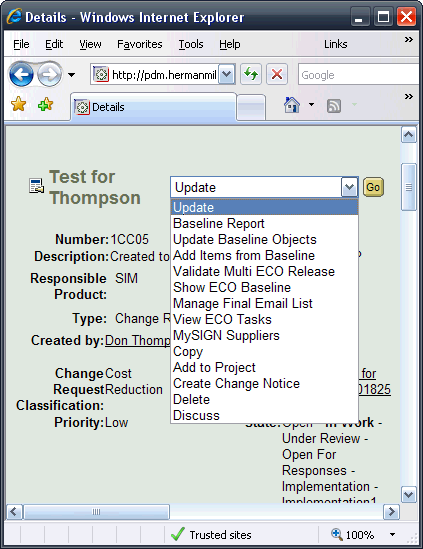

As an example, I'm trying to add the "Baseline Report" item as shown below
that will simply open a JSP page in a popup window.

8.0 Actions menu:
9.1 Actions menu:

9.1 actions are managed by wt_home\codebase\config\actions\*actions.xml and
*actionmodels.xml. For adding a link to ECR, take a look at
ChangeManagement-actionModels.xml and search for name="more change request
row actions". Copy the entire XML node and paste it to
custom-actionModels.xml and add your link action something like
<action name="baselinereport" type="hm"/">.
Within custom-actions.xml define the action "baselinereport" like this
<objecttype name="hm" class="" resourcebundle="hm.customRB">
<action name="baselinereport">
<command windowtype="popup"/">
</action>
</objecttype>
In customRB, define the RB values for baselinereport. Upon clicking on the
link, a jsp page codebase/netmarkets/jsp/hm/baselinereport.jsp will popup.
Above stated are higher level details and there are variety ways to
configure actions.xml elements. One can refer Customization manual for more
details.
