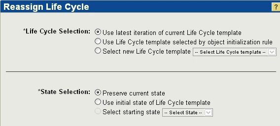

The reason I ask is that the 'Reassign Life Cycle' function includes a 'Use latest Iteration of current' insinuating that in order to reflect the latest changes to the existing state this function would need to be performed.

Cookie cutters (Lifecycle template) and cookies (objects using the lifecycle)...
Each object is assigned the Lifecycle on creation, and then again on each New Revision (Revise) action, but not when iterated. Essentially each lifecycle instance doesn't "know" the lifecycle template has changed.
The new lifecycle iteration can only be applied to all items that use the lifecycle using either the re-assign tool below or using a Windchill shell command available unofficially from PTC. The re-assign GUI shown below can be used for one or a few but of course is not practical for hundreds of thousands.
We've iterated our primary lifecycle used for most Docs / CAD Docs and all WTParts twice, and applied the changes to all items (700,000+). Takes a while - need to do on the weekend. Be careful about LC changes that remove states or those that have workflow templates mapped to them - could create a monster. Also, I believe the last time it ran we had issues with checked out items being skipped with no report of that.
