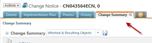

Can I display affected and resulting objects on the ECN info page? OOTB I have to drill down to task
February 20, 2014
Hello Dmitry,
Have you looked under the Change Summary on the Details page? In earlier releases there was a bug that made it not work, but it works for me on 10.1 m040.
[Description: C:\Users\BTOUSS~1\AppData\Local\Temp\SNAGHTML4f0da2d2.PNG]
Sincerely,
Brian Toussaint

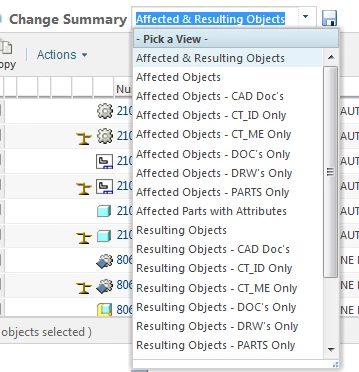

Example of additional views you may consider. OTB names don't match what users see elsewhere (Affected / Resulting) but we matched those terms here.
[cid:image002.png@01CF2E36.DE2BFC50]
We put on a new tab so this one table fills the page.
[cid:image003.png@01CF2E36.DE2BFC50]

This works fine for us in 10.0 M040.
And from your subject it show you want to show both Affected Objects AND Resulting Objects at the same time. Personally I think it might cause some confusion but some of my users like it.

February 21, 2014
It's especially helpful to show affected and resulting in the same screen when users need to:
- check that everything that should have been revised has in fact been revised
- look at differences using the compare functionality
