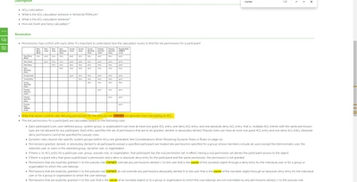

This not possible OOTB , you may refer to https://www.ptc.com/en/support/article/cs364768
