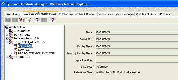

Hi all,
We are exploring an option to link WTUser Objects as IBAs to the Change Objects. The OOTB UI to create a Reference Definition limits the classes that can be selected to 'WTOrganization' and 'ClassificationNode'. Have anyone used this IBA type to link to attributes of any other type? If so, How were you able to do it?
[cid:image001.png@01CC931A.5A4A8E10]
I have also noticed that one of the attribute definitions in OOTB Attribute Organizer PTC_SYSTEM_ATTRIBUTES is referencing a class other than the two mentioned in the above screen shot. There must be a way to create the definition using the load files.
[cid:image004.jpg@01CC931B.269809C0]
Raju
Raju Pulavarthi
sjm.com
