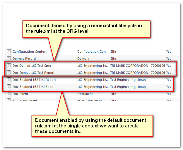

Anyone know how to control what documents are created in what Library?
If we only want some doc types created in a particular library – how do we manage that?
For example we have a DMR Library that we only want Production type documents in and another Library that we only want Regulatory type documents in.
I can Deny the Users Group the ability to Create for that Doc Type within the Policy Admin for that Library, but is there a better way than using deny?

We figured out one way to do this. Pretty laborious but works perfectly.
For all subtypes that you don't want to allow in a specific Library, create an OIR that specifies a lifecycle that doesn't exist.
Note: Works also if you specify a folder that doesn't exist, but lifecycle is better because it prevalidates and doesn't present the type at all.

Jul 8, 2015 7:15 PM UTC
Mike,
What about creating a "deny" OIR at the Org level, and then an "enable" OIR at the specific context you want to have that document be active in?  I am experimenting with this at the moment and it appears to have some possibilities
20150708-141231.png.
