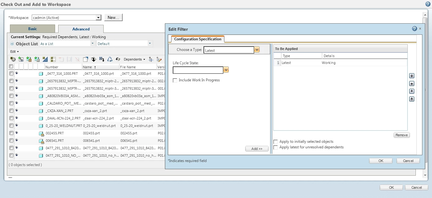

Does any one in here can help me with doing "As stored version" Checkout. I'm not able to locate it in Windchill.
Thanks in Advance.
Best answer by BuddyHudson
Hey Vineeth, you will need to go to the "Advanced" tab while executing the check-out, there is an icon that looks like a tree that has a pencil next to it. You will need to remove the "Latest" and add "As Stored". See attached image.
Vinee1-VisitorAuthor
April 14, 2014
Thanks Bryan..
