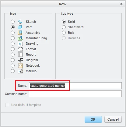

Here is what my OIR (object initialization rule) looks like.  This should pull a number only when I don't manually name the Creo object something else.
This works exaclty as expected when creating a new file in Creo.  No number is pulled from the database until an object has actually been created by Creo.

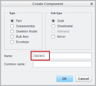

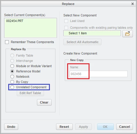

Unfortunately this falls apart everywhere else.  All of these other actions will pull a number from the database as soon as the dialog is opened:
  • Save As from Creo
  • Rename from the embedded browser in Creo
  • Assembly - Create New Object
  • Assembly - Replace (even though "Unrelated Component" is not selected)
Wasting a number every time one of these other actions is taken is making the whole thing unusable (at least for us.)  Yes, it functions, but it's not acceptable to "waste" 70% of the available numbers.  My goal was to replace manually assigning numbers from an Excel spreadsheet with Windchill's autonumbering, but that's not going to be possible if most of the numbers Windchill assigns never end up actually becomming real objects.
