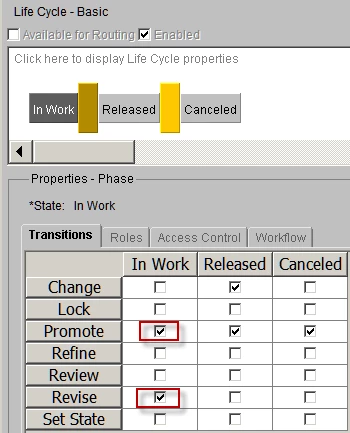

Why would you want to revise something that is "In Work"
Why would you want to promote something that is "In Work" to the "In Work" state?
Neither makes any sense to me.

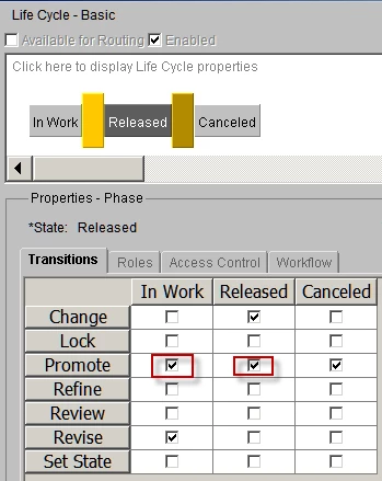

I understand Revise to "In Work"
I don't understand Promote to "In Work"
Also don't understand Promote to "Release" the state It's in already.

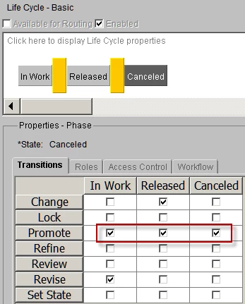

[cid:image003.png@01CDEE5A.79682C70]
None of these promotes at the Canceled level make any sense to me.
You are at the final release state; the only thing that makes sense is to revise.

Why would you want to revise something that is “In Work”:
Many companies use new revisions to reflect major changes that they make,
regardless of a state change. Without this Revise options, users would not
be able to create a new revision for objects that are "In Work".
Why would you want to promote something that is “In Work” to the “In Work”
state?
Obviously, you wouldn't. However, if you are promoting an entire assembly
to In Work (for whatever reason, maybe you don't want to create a new
revision) you would need to have all objects in the promotion request to
have the same destination life cycle state. For example, if some of an
assemblies' parts were in the Promotion Request and "In Work", they would
need to be able to be promoted from "In Work" to "In Work". This is the
same for Promotion to Released from Released.
Revise to In Work
Some companies, when they need to send a Released object back to the
drawing board, use the Revise option. This will update the revision and
move the state back to In Work.
Promote from Canceled
If you want to change the state of the Canceled object, do not wish to
create a new revision and would still like a formal approval of the state
change, promote is your best option.
