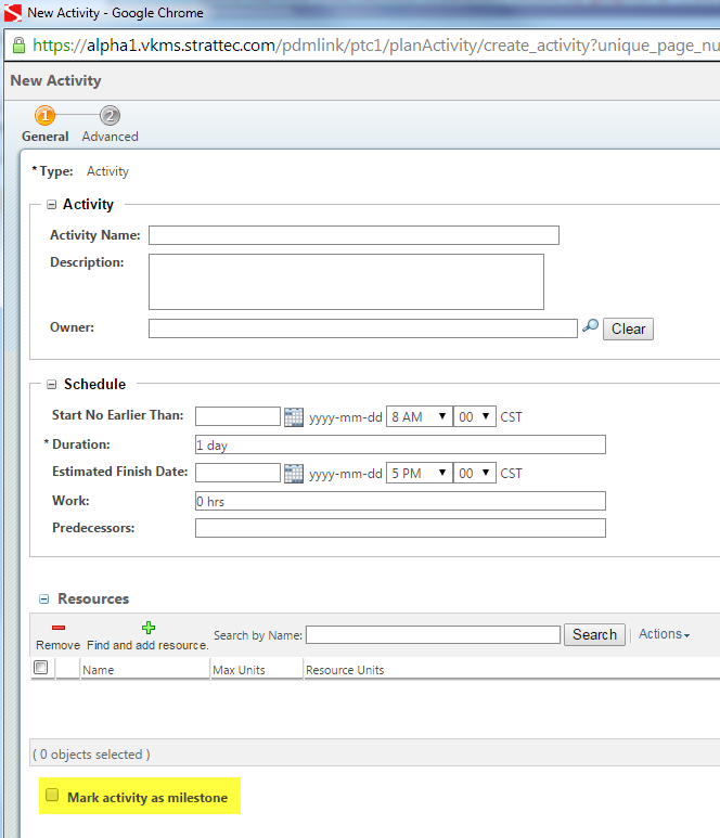

We are on Winchill 10.1 M040 and if I would like to change an activity to a milestone.
Support told me that this is not possible when a checkbox is active at the start of the project.
If I open the project plan in MS Project I can change an activity to a milestone and then save it back to project link.
Is that a bug or absolutely normal.....
Marc
November 12, 2014
I think the check box you're referring to is the one when you Create a New Activity in EPP11-12-2014+5-16-58+PM.png
I agree with you. It should be available on an Edit..... if you look at the source on the page, they are using a couple of functions "loadMilestonePicker" and "disableMilestonePicker" I'm betting it "works per spec" and that they never considered that someone might want a One-Day event to be a Milestone.
