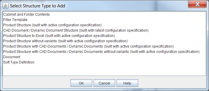

Hi, I have to deliver an entire offline copy of a producton a certain date. I've looking into using Packages but theProduct Structure viewonly contains alimited amount of data. Additionally none of the related objects are linked to the part objects. What is the best way to accomplish this? I am currently running PDMlink 9.1 M060.

May be able to share the entire product to a Project, then download all the files in the Project somehow. May or may not be that helpful though.
August 9, 2012
You should be able to do this using "EXPORT" from the Import/Export Manager located in the Product Utilities Page.

You haven't specified what kind(s) of data is contained in the product or what the intended use is. However if the data is Pro/Engineer files and the "data user" doesn't care about the different versions you could add all the files to a workspace and then export the workspace.

We have looked at the export functionalitybut it does not provide a InteractiveProduct Structure interfacewhere you can navigate through and access all the data. It does not look as though it containsall of the linkage betweenparts and related objects. It only exports documents and associatexml files with limited metadata.
As far as data contained, I need all of the CAD files, and all related object files to be included as a number of parts contain "Described By Documents" and such.The intended use may be to then import it into another PDM system, I'm not sure. I only have the requirement to deliver an complete offline copy.

If I am totally missing the requirement I apologize but I have used the export manager to export everything including Pro/E files. One of its intended uses is to import into another system. You can however specify different things to export. For example from the Add button you can specify that you only want Product Structure in Excel format or only CAD documents or any combination.

So if you export using that function, how do you view the product structure and linkage toall related objects? (other than Product Structure to Excel)

I don't think you can do it all in one export. You need to look at each ones to see what it does. For example, "Product Structure with CAD Documents" will provide xml's for EPM Members links and WTPart Usage Links. You may need to write an XML parser to read those and build the structure in an Excel file. I have not found what type of export will give the describe by links used to show what CAD describes what Part.
August 10, 2012
I havenot checked this particular data export using PLM connector but may be you cantry using it. Note - it has a limitation of exporting only Pro/Engineer CAD Data and IDEAS CAD Data.
