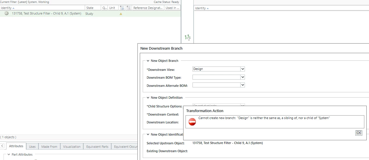

7-Bedrock
Oct 7, 2026 1:52 PM UTC
While testing Windchill 13, I encountered this error message listing the criteria for creating a downstream branch in BOM Transformer, so I think I found my answer !
The rules are: The Downstream must have a view “same as” or “sibling of” or “child of” the Upstream view.

7-Bedrock
Aug 21, 2026 10:01 AM UTC
Thanks for your response Dobi !
With same view for up and down stream side of the BOM Transformer it seems to work.
But my fear is to have another user creating an equivalence link in the other direction or on a child BOM in the product design structure, leading to a circular reference.

So the more secure solution is to create downstream view, this will be like :
0-Design
    1-Analysis
    1-Procurement
    1-Manufacturing
