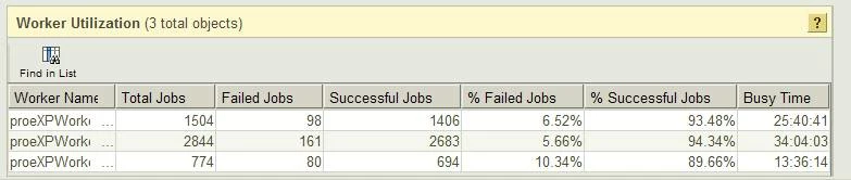

Does anyone know how you would gauge the average throughput of a CAD Worker machine.
What I'd like is on average over the course of x months it takes about x number of seconds to process the average ProE file.

Did you look at the publish stats button from the publish monitor?
