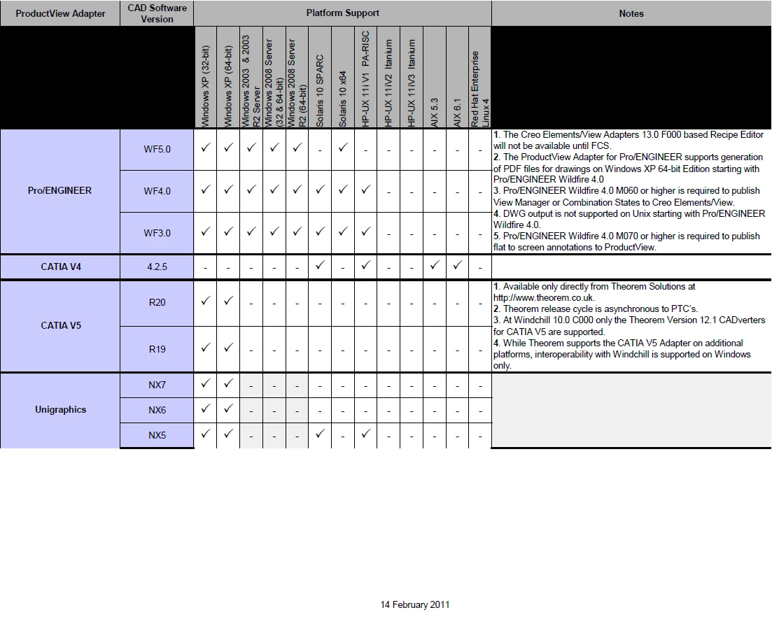

September 25, 2012
Ben,
For CAD Workers you should look at the compatibility matrices for the ProductView Adapters and not the Pro/ENGINEER software matrices. I took a look at the ProductView Adapter 13.0 software matrix and found that Windows Server 2008 is supported:

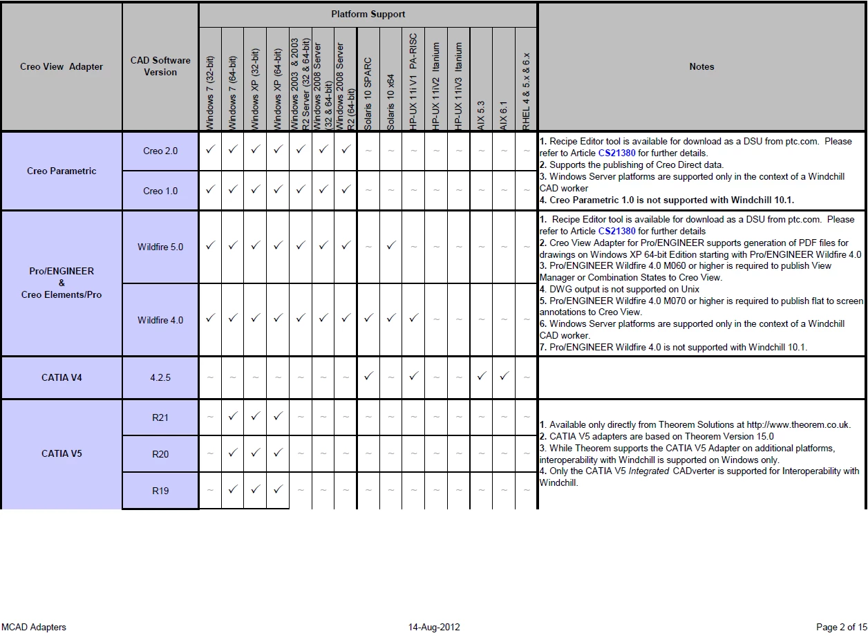

If I look at the Creo View 2.0 M010 Adapters Matrix (compatible with Windchill 10.0 and 10.1) I find that Windows Server 2008 is also supported:

September 25, 2012
Creo 2.0 does show support for Windows Server 2008 R2 64-bit with a note saying NOT Creo Schematics (if that even matters).
