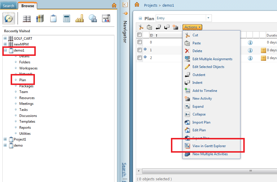

Can i track/view all my projects on windchill in form of graph or gantt chart format ?

You can go to Project --> Plan and there you will fUntitled.pngind one action button after that click on 'View In Gnatt Explorer'

Thanks it helped.
But I am able to see this " View in Gantt Explorer" option in some of projects and not in all of them.
Could you help me out why I am seeing this variation ?
Has it something to do with some setting in the project creation or windchill version migrations ?
Arun.
April 23, 2013
Sorry but I am not sure why you are facing that problem.May be there are some ACL related issue.
Login as org admin and try to see whether that action is visible or not .
