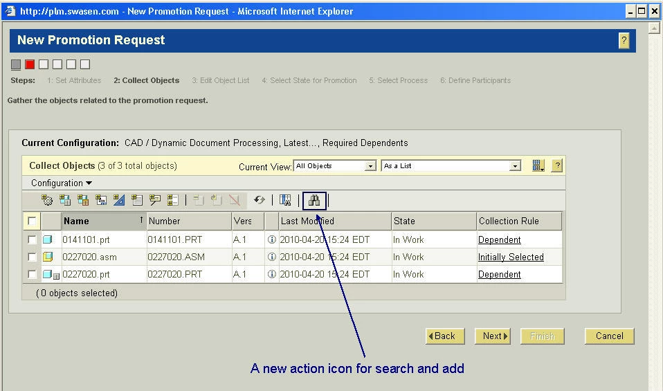

April 21, 2010
Hi
We designed a custom add on module for search and add promotable objects to
a Promotion Request - Collect Objects step. Please refer the attached screen
shot.
If this of interest, please let us know for the pricing details.
Thank you and have a great time.
Best Regards
Swamy Senthil
