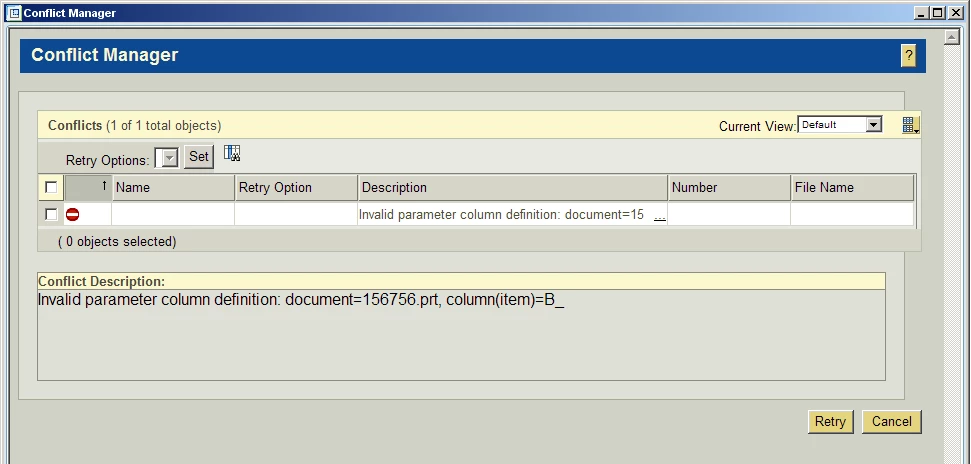

September 12, 2011
Ok, sorry for being vague. If you are having this issue where you receive the following error when checking in objects then contact PTC TS and reference SPR 2071361.
[cid:image001.png@01CC7128.CE74E6A0]
