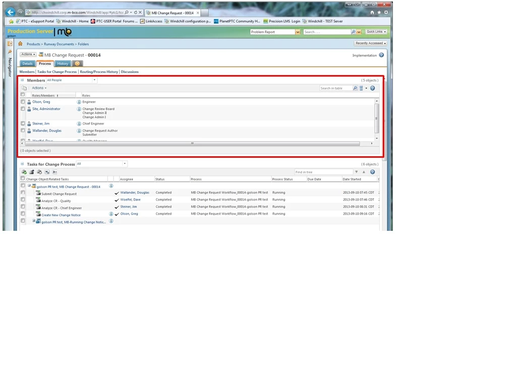

Is there a way to remove the members table from a user's view? For the average user, this is confusing and just clutter.

See below, these are the changes that I made....commenting out the members table.
-<model resourcebundle="com.ptc.windchill.enterprise.change2.changeManagementActionsRB" name="changeNoticeProcessTab">
<action name="changeWorkItemsTable" type="changeNotice"/">
<action name="processHistory" type="workflow"/">
<action name="discuss" type="forum"/">
I am a bit confused, do I leave the orginal xml (changemanagement-actionmodels.xml)file alone and copy all of the above
to the custom-actionModels.xml file?
<listofactions/>
Above is our custom table OOTB, what should it look like?
I am a novice when it comes to customizing UI.
Greg
