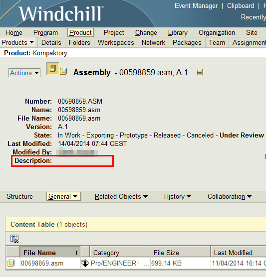

don't you know how can one change an EPM Document's description?
I've found no action in user interface.
We are currently on 9.1.
Best answer by LoriSood
This particular Description attribute is only editable when creating the CAD Document via "New CAD Document". Please refer to https://www.ptc.com/appserver/cs/view/solution.jsp?n=CS40105 for more information.
