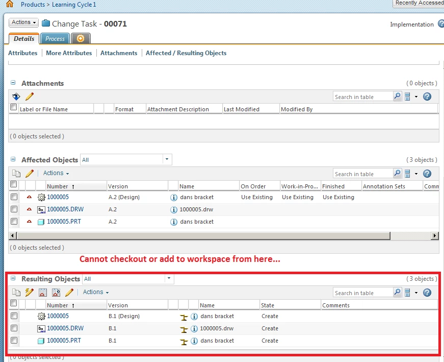

For those of you familiar with the Change process, I have a question for you. Why is it that I cannot perform a checkout (or Add to Workspace) operation on the objects that are in the Resulting Objects table within a Change Task? I have to click Info on the objects first and then check it out from the Actions menu.

We'd like this as well.
February 24, 2012
It's probably just configuration of the actions ? Not too difficult to add?
Sent from my Verizon Wireless BlackBerry
February 25, 2012
Unfortunately add to workspace and check out actions do not work in the resulting data tables. This is true for 9.1, not sure about 10. I know there some talk about adding this not sure if it was for 10.1 or just future versions.
