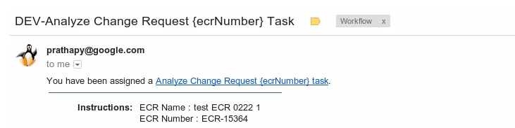

Hi all,
We are using Windchill 9.1. OOTB email notifications for the
workflow task notifications have generic subject with Activity name such
'Approve task' , 'Review task'.
I am trying to find a way to add the ECR/ECN number to the subject such as
'ECR-1234 Approve task', 'ECN-2345 Review task'. I am wondering if there
is any way of extending notification processors and add this to all the
tasks.
Any pointers will be helpful.

Hi Prathap
educated guess: From the start transition tab, programmatically alter the
assigned activity name. That should be reflected in the email subject.

The following example might work well for you in the start transition of
your activity.
//Define the Activity Name
String ecnNumber =
((wt.change2.WTChangeOrder2)primaryBusinessObject).getNumber();
String MyActivityName = "Analyze Change Notice " + ecnNumber
//Set the Name
wt.workflow.engine.WfActivity myActivity =
(wt.workflow.engine.WfActivity)self.getObject();
myActivity.setName (MyActivityName);
myActivity = (wt.workflow.engine.WfActivity)
wt.fc.PersistenceHelper.manager.save(myActivity);
Feb 23, 2012 12:12 AM UTC
You need to modify the activity in the start transition and persist/modify it. The email notification OOTB takes care of the rest.

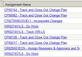

22-Sapphire I
Feb 23, 2012 1:59 AM UTC
We include the PBO Number in front of the assignment Name dynamically, as shown here (rather than including the subject). This number carries thru related emails. It's also very helpful because all reporting on completed assignments (tasks) can be filtered by the type of object.
[cid:image001.png@01CCF183.478D8AD0]
Feb 23, 2012 2:16 AM UTC
Thanks Mike this the solution I was referring to.
Sent from my Verizon Wireless BlackBerry
Nov 21, 2014 2:35 AM UTC
Hi Mike,
I know this is an old post but, how did you add the ECN number to the front of the Workflow Task name? I tried to add {primaryBusinessObject} to the Name field of the Activity node but that didn't work.
