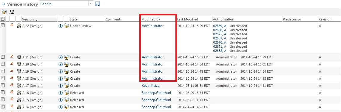

I have a workflow with a Checkout Method robot that checks out a WTPart to the Creator Actor. Then after some processing I have a Checkin Method robot. When I look at the history of the object I see that Administrator was the last modified. I would have expected the Creator principal to be listed in the history. Am I missing something? Can someone tell me how this should work?

Patrick,
Try the following logic (on a test server) and check if it makes any
difference.
Use "SessionHelper" API to set the current principal to creator
Implement your business logic (check out and check in)
Reset the current user to administrator using "SessionHelper" API
*Note:*
- Please test this behavior before making changes to production environment
- You may use following APIs
WTPrincipal administrator = (WTUser) SessionHelper.manager.getPrincipal();
SessionHelper.manager.setPrincipal(creator.getName());
SessionHelper.manager.setPrincipal(administrator.getName());
