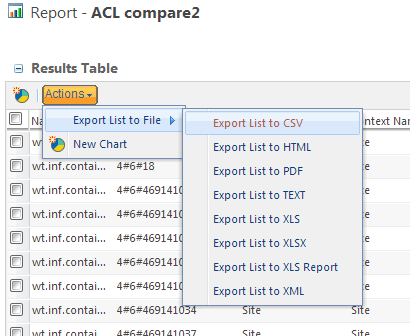

If you need to quickly compare ACL rules between 2 systems e.g. production & test, additional steps are required so that file comparison tools can be used. The following method uses the comparison tool “Beyond Compare” to check for differences between CSV files, generated by a QML report (attached).
The ACL CSV output
  1. One line per rule.
  2. To make it readable the results are sorted (context, domain, object type, state, principal)
  3. To ensure the comparison tool knows which rule on left to compare to which rule on the right we must add comparison key columns to the data output. The key is expected to be the same on both systems, else the ACL rule is considered to be unique to just one system.
The attached QML, generates a suitable CSV output file and contains 2 keys which can be used for comparison. You can create more keys to suit your requirements. The key is simply a concatenation of data.

When comparing rules from a single context or domain, filter the report before generating a CSV file.
