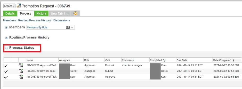

Hello, please tell me how to use Query Builder to get a report that will display the contents of the "Process Status" table from the "Promotion Request"?
I want to output all the queries for a certain period, but I failed in solving the issue.

There isn't a "Process Status" table on Promotion Request - likely you are interested in something similar.
Regardless, I can help if you  are more specific.  Maybe screen capture from a Prom Req what you'd like to see in a report.
TomU
September 2, 2021
@MikeLockwood wrote:
There isn't a "Process Status" table on Promotion Request...
Yes there is:

VladiSlav17-PeridotAuthor
September 3, 2021
thank you very much for your answer. You helped me, this is what I need.
