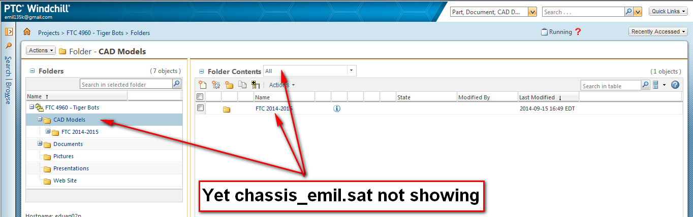

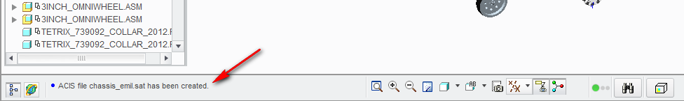

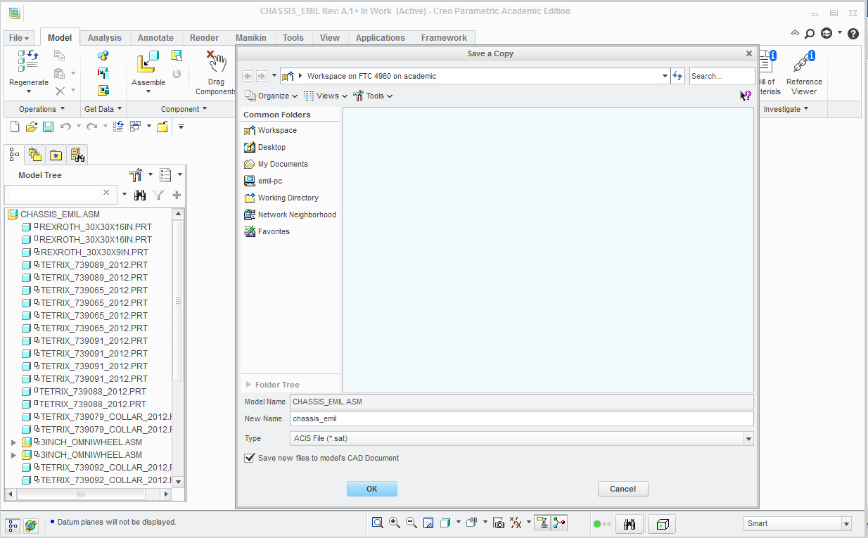

When I do a Creo Parametric 2.0 "Save a Copy" within Windchill, it states it has been successful at creating but I cannot find anywhere within Windchill folders. See screenshots of steps below...
Yet that file does not appear in any folder within Windchill.
Any suggestions?

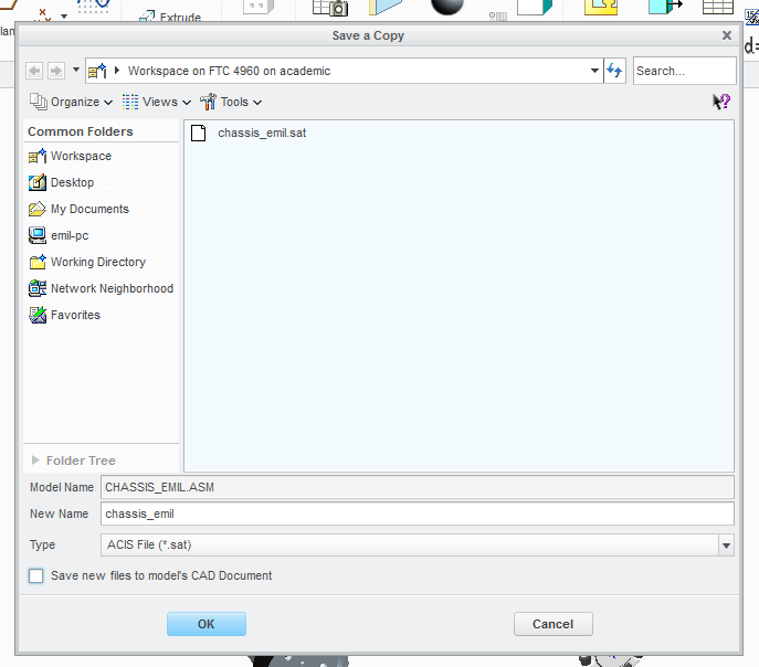

Best answer by TomU
Look again at your first picture. You saved the new file as an attachment to the existing CAD document. If you want the new file to be managed separately, you have to uncheck the box, "save to files to model's cad document" when saving.
Keep in mind that saving anythingto a workspace connected to Creo will automatically treat that file as a CAD model, even if it's not (PDF, IGES, STEP, DXF, STL, etc.). If you want to treat it as a (non-Creo) document that can be managed outside of Creo, then you should save it outside of the workspace (desktop, etc.) and then manually add it to a new (Windchill) document.

I'm not sure. It isn't a file type that would ordinarily be managed that way, but a data file separately attached to a document record type. You can see the checkmark beside "save new files to model's CAD Document."

Here is view from Windchill...
to share internally with the FTC Team in a formats more friendly to tools that output to .FBX format for animation purposes. As I am trying to use Windchill as the onestop team file center, and because I am using Creo Parametric, I was hoping it would be fairly seamless; however I seem to be runnng into difficulty. Trying to see the viability of solely using Windchill rather than our typical Google Drive.

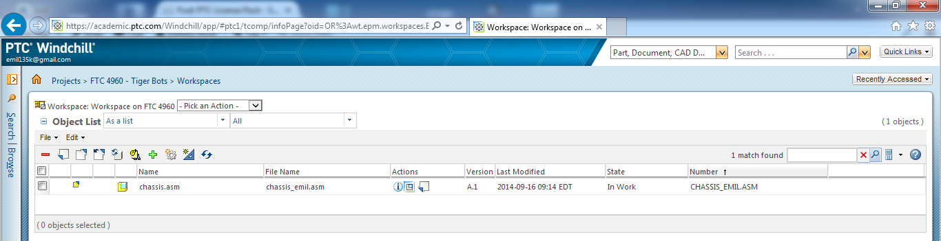

erivas1-VisitorAuthor
September 16, 2014
Shows in workspace in Creo Parametric...
but not in workspace from Windchill's perspective???
