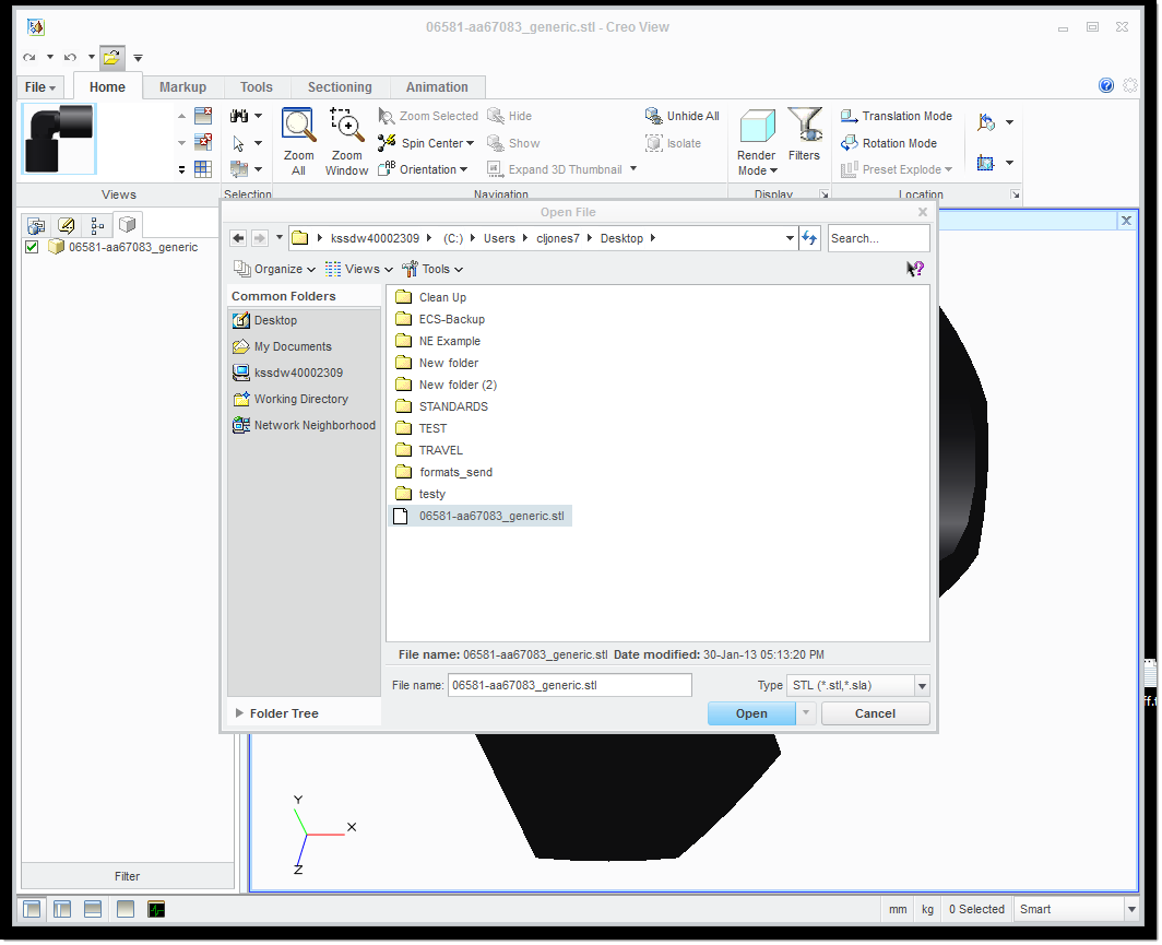

I am able to open an .stl file in MCAD, I do not see the option under Lite.
Corey
Corey
