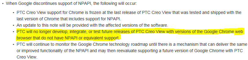

Brian, thanks for the info. PTC tech support just got back with me and said the same thing:
According to CS197208, Google Chrome has plans to discontinue NPAPI support, which is what Creo View uses to work in embedded mode. According to the Chromium website:
April 2015
In April 2015 (Chrome 42) NPAPI support will be disabled by default in Chrome and we will unpublish extensions requiring NPAPI plugins from the Chrome Web Store. All NPAPI plugins will appear as if they are not installed, as they will not appear in the navigator.plugins list nor will they be instantiated (even as a placeholder). Although plugin vendors are working hard to move to alternate technologies, a small number of users still rely on plugins that haven’t completed the transition yet. We will provide an override for advanced users (via chrome://flags/#enable-npapi) and enterprises (via Enterprise Policy) to temporarily re-enable NPAPI (via the page action UI) while they wait for mission-critical plugins to make the transition. In addition, setting any of the plugin Enterprise policies (e.g. EnabledPlugins, PluginsAllowedForUrls) will temporarily re-enable NPAPI.
So, it appears your next step here would be to access chrome://flags/#enable-npapi and re-enable NPAPI for the time being. This should work until September 2015 when Chrome 45 is released.
For those who can't read CS197208, here is the relevant part:

I'm still surprised an announcement wasn't sent out from support warning of this coming problem. This would have allowed us to be proactive instead of reactive. The article was written almost 3 months ago.
