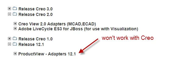

When we switched from WF4 to Creo last week, we also upgraded the settings for the publishing machine and put a local copy of Creo on it. Went through the Adapter.pvi and the Workder.rcp files and updated them to work with Creo2. We were already running the CreoView Adapters, so the only change was Creo2 from WF4. When we start the GS Worker as a service creo will not launch. The GS Worker is calling WorkerDaemon.exe. If I open a command prompt and run WorkerDaemon manually, then I can get Creo2 to start from the Worker Agent Administration window.
Has anyone else had this issue with Creo2 or CreoView? PTC seems stumped on my open call.
