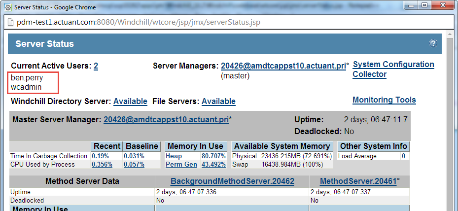

You got me thinking. Below is a screenshot of a customized <WT_HOME>/codebase/wtcore/jsp/jmx/serverStatus.jsp file.

1. Open serverStatus.jsp.
2. Find
Integer activeUsers = null;
Below that, add a line to instantiate an array for the active users.
String[] activeUserArray = null;
3. Find
activeUsers = (Integer) mbeanServer.getAttribute( activeUsersMBeanName, "TotalActiveUserCount" );
Below that, add a line to populate the activeUserArray variable.
activeUserArray = (String[]) mbeanServer.getAttribute( activeUsersMBeanName, "TotalActiveUsers" );
4. Might need or desire to add an entry to the catch block for activeUserArray.
5. Add the display of the variable anywhere in the page. Look for the screenshot as to where I added it. Code for my addition of the variable to the page is listed below. I looked for
decimalFormat.format( activeUsers )
and added another <tr>below the existing one to show a list of the users. This is probably not the best location to add it because a large list would push all of the stats down the page. The best location to render this on the page is probably at the bottom of the page. But this just serves as proof of concept at this point.

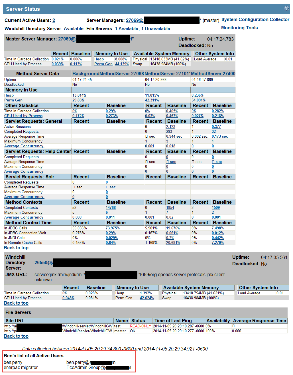

I have modified my customization. I have been doing a lot of restarting of my 10.2 test system and did not want to keep clicking into Master Server Manager hyperlink, and do a Find for "ActiveUsers". Too many clicks. I decided to implement my customization for good, so that I can simply navigate to http://<host>/Windchill/wtcore/jsp/jmx/serverStatus.jsp and immediately see who is using Windchill. A benefit is that this URL is bookmarkable, whereas the URL to the Master Server Manager is not.
Futhermore, I decided to take things a step further and return the email address of the users currently using Windchill. That way I can copy and paste into the TO field of an email if I need to send them an email for some reason.

5. Add the display of the variable anywhere in the page. Look for the screenshot as to where I added it. Code for my addition of the variables is listed below. I added it as the last table on the page, right before the closing </body> and </html> tags.

<%-- Custom table for displaying usernames --%>
<table>
<tbody>
<tr>
<td>
<b>Ben's list of all Active Users:</b>
</td>
</tr>
<tr>
<td>
int i=0;
for (i=0;i<activeUserArray.length;i++) {
out.print(activeUserArray[i] + "<br />");
</td>
<td>
int j=0;
for (j=0;j<activeUserArrayEmails.length;j++) {
out.print(activeUserArrayEmails[j] + "<br />");
</td>
</tr>
</tbody>
</table>
