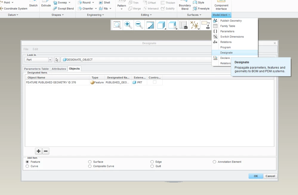

When I designate an object (more specifically a feature or quilt) in Creo, how do I see it in Windchill, what will its relationship be to the CAD document, is anyone using this functionality? I am looking for a way to show that a part has published geometry from within Windchill.

Hi Craig, Im interested in the functionality of Designate (Model Intent > Designate) rather than Designated area.
As below, in addition to parameters, I can designate also designate Features, Surfaces, Edges, Quilts, Annotation elements and Curves. The tooltip suggests that there is a way to see these designations in PDM.
There is some documentation, but its not clear how these designations can be shown in PDMLink
