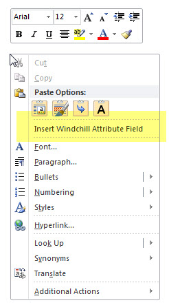

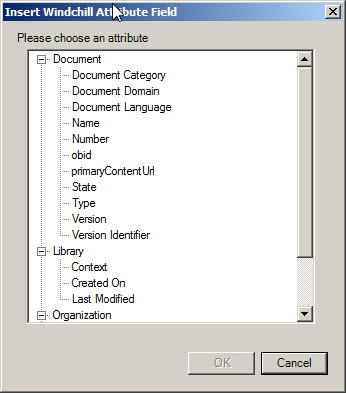

The attachment is based on MS Office 2007.  For 2010, there is an option in MS Word 'Insert Windchill Attribute Field', which gives a nice overview of insertable attributes.

    Hugo's comments are spot on. RIght Mouse Button is the best way to insert Windchill attributes in Excel or Word (Office does not support document properties in PowerPoint). The only caveat is the document must be checked into Windchill at least once before adding the attributes.
March 5, 2014
The process of inserting attributes is covered nicely in the Windchill Help Center under the "Inserting a Windchill Attribute" topic.
