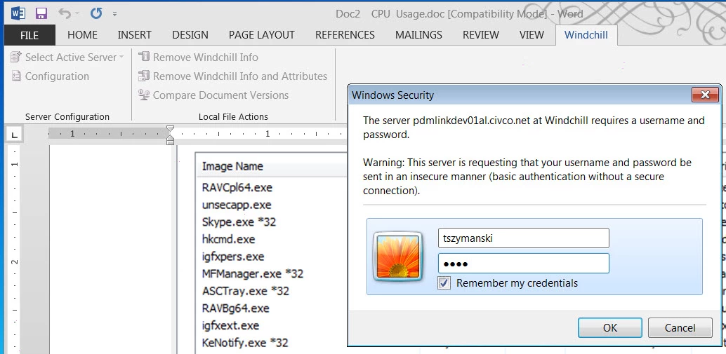

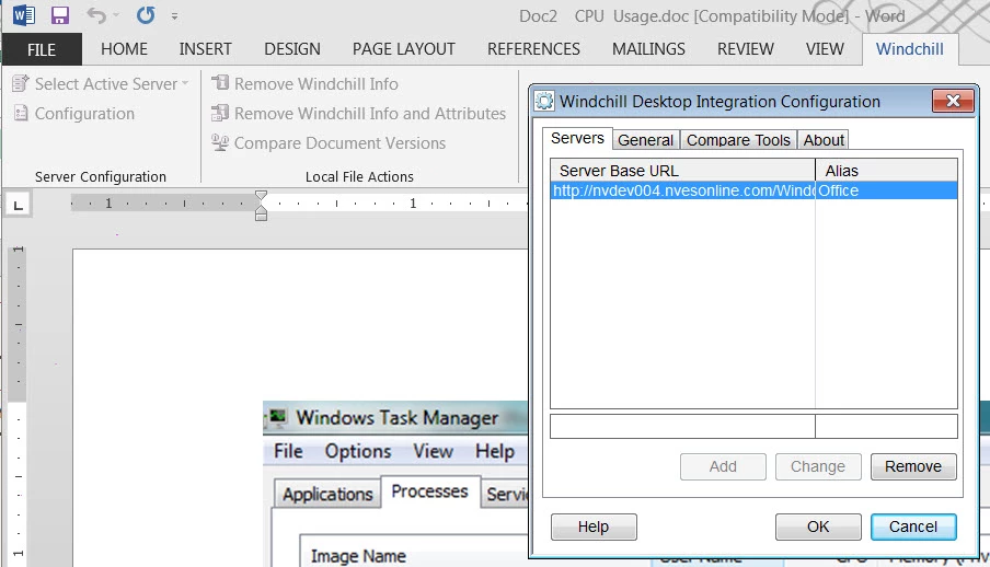

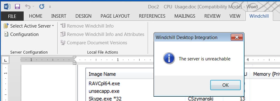

Anyone seen this?
When trying to connect MSOffice to Windchill, I get the LDAP authentication login, and then upon login I get an error message stating that the server is unreachable. This happens with any conction to Windchill; from a MS product, registering a server in Creo, and through the windows explorer. I can ping the server and login just fine through any external browser. See screenshots. I have a call logged with PTC, but they have been unable to figure it out yet.
Thanks for the help!
Terry

I had some issues at first too. If you don't set the download mechanism to desktop integration, you will see the errors that you are getting or something similar. The comment about adding the site to the approved or trusted sites list is also necessary in order touse the integrated check in feature. I hope this helps.
March 21, 2014
At Windchill 10.2, you should not need to change the Windchill Attachments preference, Download Mechanism, manually. PTC implemented a new client configuration that will go check the value of this preference and change it automatically once you have authenticated and connected.
The application cannot change this preference during installation, because we don't have user credentials and don't want to ask for them. Instead, we go check the preference when WTWindows is launched.
As far as how it does not work, Chris was spot on. If the download mechanism is set to Browser, all downloads will be handled by the browser's configuration and not the DTI application. Once changed to DTI, all Windchill downloads will be handled by the DTI application and directed to the right application. This was the primary reason we added the preference check in Windchill 10.2.
