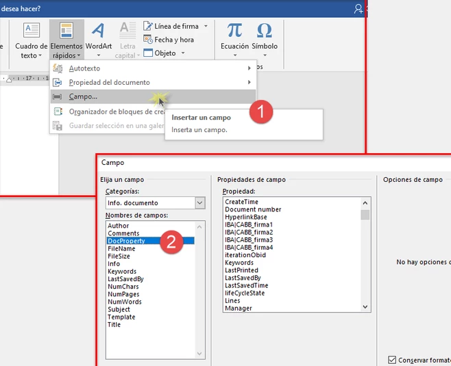

I always use Word function "Quick Parts" to show Windchill attributes in MS Word.
It is much more stable and powerfull.
Microsoft also is using Quick Parts for Sharepoint attributes 😉
Oct 19, 2020 1:38 PM UTC
@jvonzastrow1
When I use "Quick Parts" I do not see the attributes from Windchill.  Do I need to do something to create them? I was reading some of the limitations based on CS194304 and it looks like Quick Parts do not auto update on open but need to be refreshed.
Oct 19, 2020 2:14 PM UTC
If you want to use as Quick Parts, then instead of document properties, you need to select Field > docProperty and you will see all Windchill properties there:
