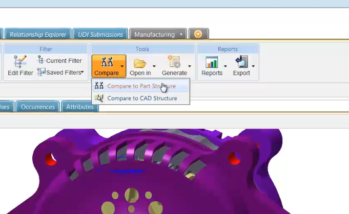

Step 1: Access the Report
To start, access the Multi-Level BOM Compare report from the Structure page of any object.

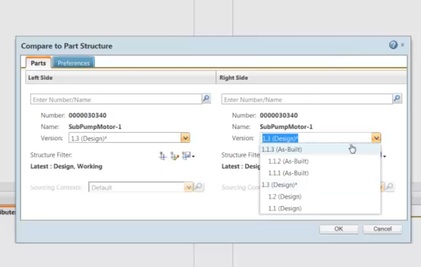

Step 2: Specify a “source” and a “target” Bill of Material
For this type of report a source and a target BOM are required for the comparison. By default the product structure that the report was initiated from is automatically selected as the source for the report. The target BOM must also be specified. Your choices are to search for and select an entirely new BOM, select a specific configuration specification, or select a saved expansion criteria.

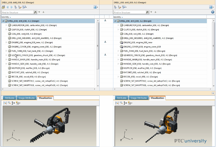

Step 3: Understand the final reports
The generated report will look similar to the image below. In this case the BOM comparison was done on an overloaded BOM and the BOM was filtered on specific option choices. The information on the left side pertains to the source BOM and the information on the right side pertains to the target BOM. In the tabulated area, the information shows that there are several components in the source BOM that are not in the target BOM. This type of report is particularly valuable for BOM configuration and interrogation and change audits.
