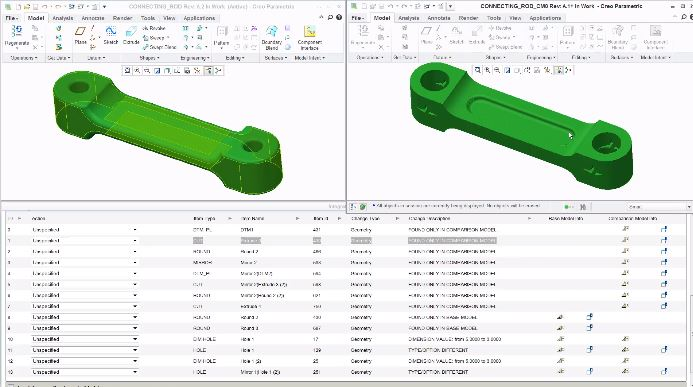

To help you follow along, shrink the “base model” (version A.2) dialogue box and move it to the upper left hand corner of your screen. Then take the “integrate differences box” and stretch it across the entire bottom half of your screen. Finally, take your current version (the one you are making the changes to), which we’ll call the “comparison model”, and drag it to the upper left hand corner of your screen. It should look something like this.

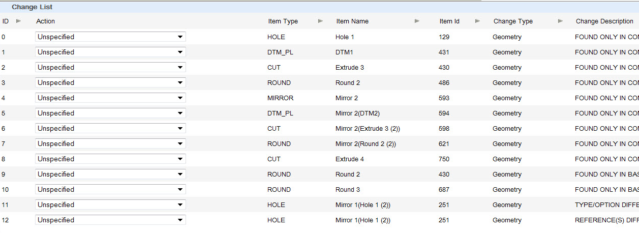

Now, let's begin the model integration process. First, you'll want to filter for geometry differences by checking “geometry” in the integrate differences box; scroll down to identify the main geometry differences between the base model and the comparison model.

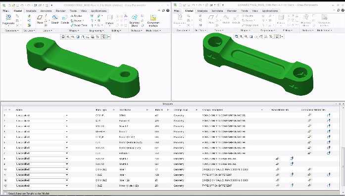

To bring a feature that's unique to the comparison model over to the base model, simply highlight the row of information for that feature.
Note: When you highlight a feature row in the integrate differences box, that feature will also highlight in the actual model.
To keep this change click the “Action” dropdown menu and select “take from comparison model”. Then click “Execute” found at the bottom right hand side of the differences box. You've now brought a feature over from the comparison model to the base model.
Continue by going down the list - line item by line item - to look at all the differences between the two models. Remember to refresh your screen so that when you click to highlight features, any differences will be graphically pointed out for you in the model as well. As you do this you can decide which features you want to keep and which ones you want to move to the comparison model.
