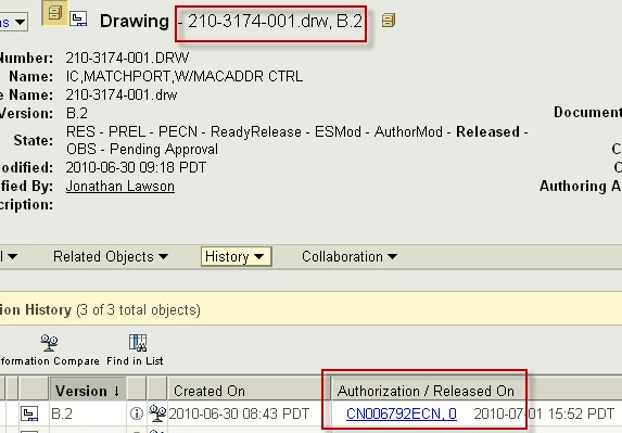

July 29, 2010
The goal that we have is for this info (the Windchill Change Notice Number) to parametrically populate the Drawing Revision Block (haven't figured out how to do this yet):
[cid:image002.png@01CB2EFB.90C5EB30]
July 29, 2010
Stephen D. and company,
The last few companies that I have take a turn with have not maintained
revision history on their drawings. In fact the last company did not even
have what I would refer to as an ECN system. It seems like most companies
are keeping archived copies of their drawings on some kind of go-between
software. This way they don't need a license from PTC to plot or view their
drawings.

July 29, 2010
Actually, folks, this is the BEST way to use that information (if you can).
Thanks for sharing this with us Mike. Let us know if and when you get it
debugged.

July 30, 2010
We still have the revision history block on our drawings, but we only use it to record the Change Request Number of the current revision.
We're also looking at adding columns for the Life Cycle state and Release Date. The Life Cycle state would be populated by the system attribute. We'd like to do the same thing with the Release Date, but we haven't come up with a good way to pass the CN Resolution Date back to ProE.
In Reply to Stephen Drzewiczewski:
Does your company still include a Revision History block on their drawings? If so do they include ECN Numbers and descriptions of the changes?
22-Sapphire I
July 30, 2010
1. Seems that the Change Notice, not the Request number should be used, because the system considers that the Notice is what authorizes the new Revision (see the History, Revision report).
2. Having the state and/or any date populate the actual drawing table can't work. It requires that the object on which the state is changing or against which a date is being recorded be iterated.
a. This is a fundamental concept. Need to have a separate mechanism to show those metadata elements that can change after the drawing is checked in (state and various dates). ProductView watermarks provide this mechanism.
August 3, 2010
Though I agree 100% that ProductView is the best way to do this with watermarking, it can definitely work showing state/date info on the drawing. As a Windchill Admin this is exactly what I did. We weren't really "enterprise" with Windchill at the time but I wanted to show the date info on the drawing in Pro/E to always be indicating to designers/engineers what state was. Again, I agree ProductView watermarking approach is best and in retrospect I would have done that. But it CAN work.
The data information never changes, even if a republish occurs, so there are no worries there. But keep in mind that the PTC_WM_CREATED_BY/ON parameters show the date of that specific REV creation, not the initial rev creation. The PTC_WM_MODIFIED_BY/ON show the most recent check-in date. Again those do NOT change through a republish.
The state of course can change, but the property publish.republishonepmdocumentchange=true causes a republish if that happens, therefore the text you see on the drawing for state will show correctly after the republish. This does NOT cause an iteration.
