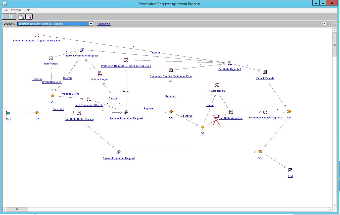

Nov 1, 2016 11:09 AM UTC
Thanks for that promising workaround.
But unfortunately, I am new to "Winchill PDM System hacking". So I would appreciate any hint where to start. Especially step 2 seems quite sophisticated to me.
Intuitively, I would insert Your workaround right before the "set state approved" step.

Matthias Rehs‌,
You're going to need to put the
approvedBy = ((wt.org.WTUser)wt.session.SessionHelper.getPrincipal()).getFullName()
code in the COMPLETE transition of your "Approve Promotion Request" task.
You can also put the call to the external class there too ... or you can put that in an Execute Expression robot.  It is your choice.

BenPerry
Dec 23, 2016 11:53 PM UTC
Mike,
I don't understand where you're going with your response.
We're investigating the use case supplied by Sanjay:
  1. Drawings are completed.
  2. In the change (CN in our case) workflow, there is an approval task to UserX.  UserX reviews & approves the drawings.  They sign off on their workflow task.
  3. Workflow code captures the user's Full Name who completed that "Drawing Approval" workflow task.
  4. Workflow code pushes user's Full Name (via IBA) to a parameter in the drawing which is displayed in the title block of the drawing, thus automatically populating that field on the drawing instead of manually updating it.
  5. The state of the drawings also flip to Production state after this task, so they are no longer editable.
I'm not sure what you're describing with the "circular flow" reference.  ...And regarding your comment about watermarks ... do you think we can achieve this requirement with watermarks?  That might be interesting to investigate.  I'm not sure yet.
